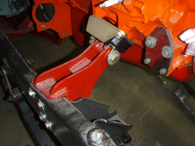

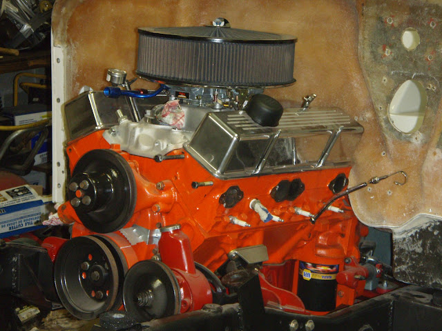

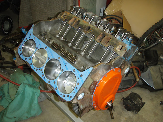

Fiberglass tub, one piece front clip, 350 Chevy V8, T150, Dana20 tcase, factory axles...for now.
Here's the pics guys!!
I want to say thank you to both Ken (for the sweet deal) and to Mike for bringing Ken to the board. Without either of you this wouldn't be possible.
Sexy motor
Shackle reversal kit
Is this clean or what...
Sweet motor mounts
I'll work hard to continue taking progress pictures and giving regular updates, but with two kids and a wife i make no promises.

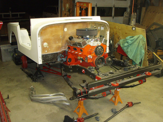

Ken, you've got a sump gas tank?
How about bump stops, or rear spring hangers?
Looks like i'm going to move the motor/tranny/tcase up about 2" so my headers fit and so my HEI distributor fits....that should be fun.

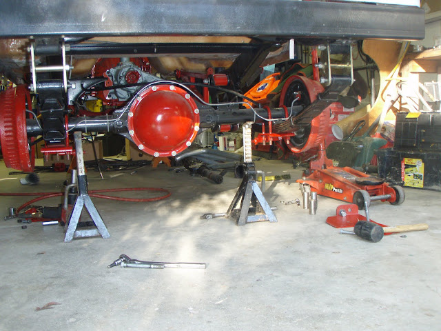

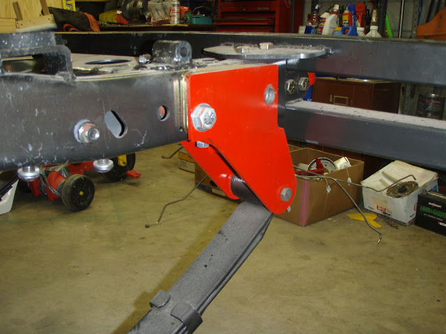

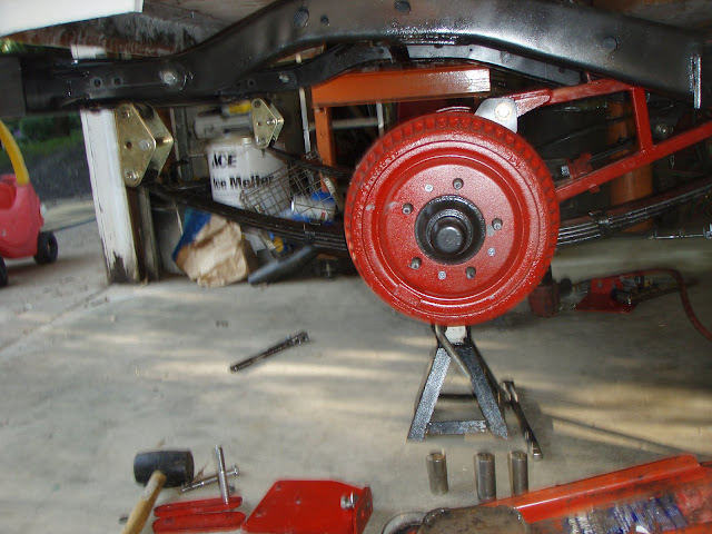

I got the rear axle in
nice track bar (shackle with heim joint up front)
Boomerang shackles in the rear

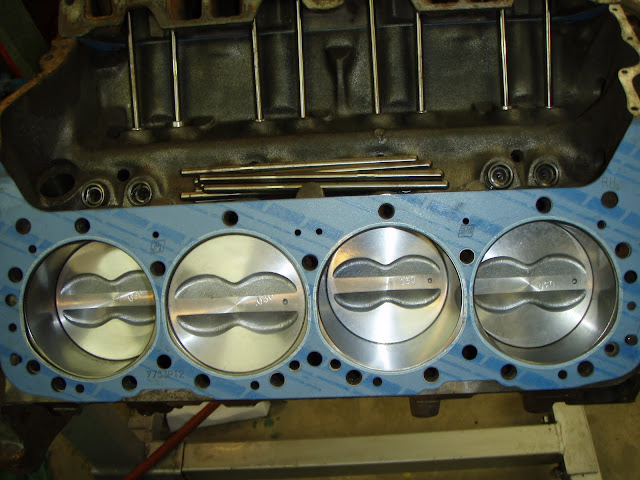

Well i'm glad i opened up the motor...i wanted to put in my cam and my other heads. i found a motor that hasn't been apart for awhile...lots of crud packed around the head bolts (under valve covers) and a fat ring of carbon build up at the top of each piston. Now i've got to decide if i wanna rebuild it or not.
I don't have much more money for this project...
pooo

Well i'm glad i opened up the motor...i wanted to put in my cam and my other heads. i found a motor that hasn't been apart for awhile...lots of crud packed around the head bolts (under valve covers) and a fat ring of carbon build up at the top of each piston. meow i've got to decide if i wanna rebuild it or not.
pooo
NNNOOOOOOOO!!!!!
-Forest
DD: '96 Chevy K2500HD, ext. cab, LB, 4x4, 5 sp, PMD relocate, air filter retrofit, Banks Exhaust, 6.5L "F" diesel, Hideaway gooseneck hitch, Rear bumper hitch, Pyro Gauge, Boost Gauge, custom fog lamps mounted on a custom front hitch, DIY wastegate, A/C delete.
Wish List: some sort of scangauge, muffler & CAT delete, Walbro fuel pump & marine fuel filter, Feed the Beast mod (have fittings already)
 Post subject: Re: CJ7 Fiberglass, 350...
 Post Posted: Thu Aug 27, 2009 9:26 pm
pooo
just file it round again and shove it back in...

Ken wrote:
Sorry to hear about that motor - I told ya all I knew about it - Ken
No worries, i'm going to tear it down completely, get it mic'd and go from there. It'll at least get new rings.
I'm just worried about the "fresh" transmission and transfer case now....

Here's my sticky motor...
From CJ7 Project
From CJ7 Project
From CJ7 Project

Progress has been slow, however; i did get the tie rod flip insert welded into the knuckles, and i'm working on getting the new motor together. Waiting on a new set of head bolts to come in.
here's some pics

Now just as a disclaimer, i'm no professional motor guy. I don't know what durations my cams got, i don't know about flat top or dome top pistons, i have learned how to put them together so they run though...and i know how to buy parts online, but other than that...i'm clueless :-)
I've got the motor alomst back together. It's bored .030 over, comp cams Extreme4x4 cam, cloyes gear drive timing, heads have hardened seats and Z28 Camaro valve springs, edelbrock performer intake and some huge carb i might change.
From CJ7 Project
From CJ7 Project

 Post Posted: Thu Oct 15, 2009 3:57 pm
Are those pistons i had in it called flat tops even though they've got the cut outs for the valves? Just curious.
Yes, they are flat tops, even with the valve notches. For a "dished piston" the entire top of the piston would be concave. (think reverse dome)

I would not call those pistons flat tops - to me they are a relieved piston - remind me and I'll tell ya an easy way to mask gasket surfaces (beats scraping) - Thanks but there is a big difference between a street racer and a drag race king (mostly $$$$) (guess it's better than being called a drag queen though - ha ha ) Thanks for looking for a skid plate - going to switch to a T 700 along with my NP 205 so I need a wider plate than stock I think??? - Ken

Update, the motors in, and i picked up a bunch more parts from Ken last weekend. Thanks again ken, it was good talking with you.

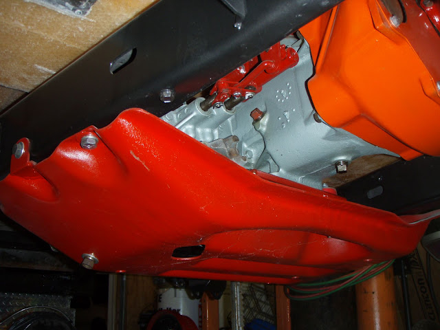

 Post Posted: Sat Nov 14, 2009 7:52 pm
Give me some slack, i've got kids and a wife :-)
I know it doesn't protect anything from anything, but i don't see this thing going anywhere offroad at the moment, and if i chose to, i can mod this one into a sweet skid plate that'll weigh more than the tub :)
i used 2x2x1/4" thick angle to make the cross member, i'm really happy with how it turned out.
From CJ7 Project
From CJ7 Project
From CJ7 Project
Pedals, steering, and seat
From CJ7 Project
From CJ7 Project
From CJ7 Project
From CJ7 Project

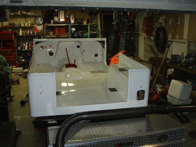

I got the doors mounted :-) i had a dream last night about using a rachet strap to hold the door on while i drilled the holes for the hinges!! it worked great! i just hooked one end to the seat bracket, and the other end to the door closing handle. made it snug and aligned it then drilled and hung the doors!
From CJ7 Project
From CJ7 Project
From CJ7 Project
And one of the motor
From CJ7 Project

oh and your picture of the motor is actually a duplicate of the pic above it if you didnt notice...lol
 Post Posted: Thu Jan 28, 2010 9:11 pm
Looks good :2up:
 Post Posted: Thu Jan 28, 2010 9:48 pm
Very Nice :tu2: She is coming right along chuck.Can't Wait to see her in paint.
 Post Posted: Thu Jan 28, 2010 10:31 pm
Fixed it

I got my door strikers in today and got the passenger side installed, i think it looks ok. Once it's all painted you won't notice much.
From CJ7 Project
From CJ7 Project
From CJ7 Project
From CJ7 Project

I was poking around on the motor today, set it to TDC, pulled the number one plug to see if i was on the compression or exhaust stroke (stick a 3/8" fuel line in the hole and blow. if you can blow freely it's on exhaust). When i pulled the plug out it was wet......not a good sign. I'm worried that my head has a crack in it and is leaking water into No. 1. the last motor i had these heads on got water in the oil immediately and i thought it was a cracked block because i told the machine shop to magnaflux these and check for cracks, they said they did and that they were good to go....i'm beginning to think that's not the case.
more to come later
 Post Posted: Thu Mar 04, 2010 12:26 pm
She rumbled to life this morning! i had the distributor 180 degrees off. Now i'm hooking up the fuel tank and lines. Should be running by next week!!!

Well i'm burning antifreeze from the left bank. i'm going to tear down the motor and have the heads checked for cracks...we'll see.
