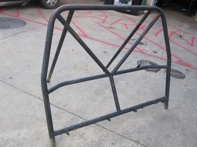

Also have a b-pillar rollcage that would weld into a grand as well (cheap).

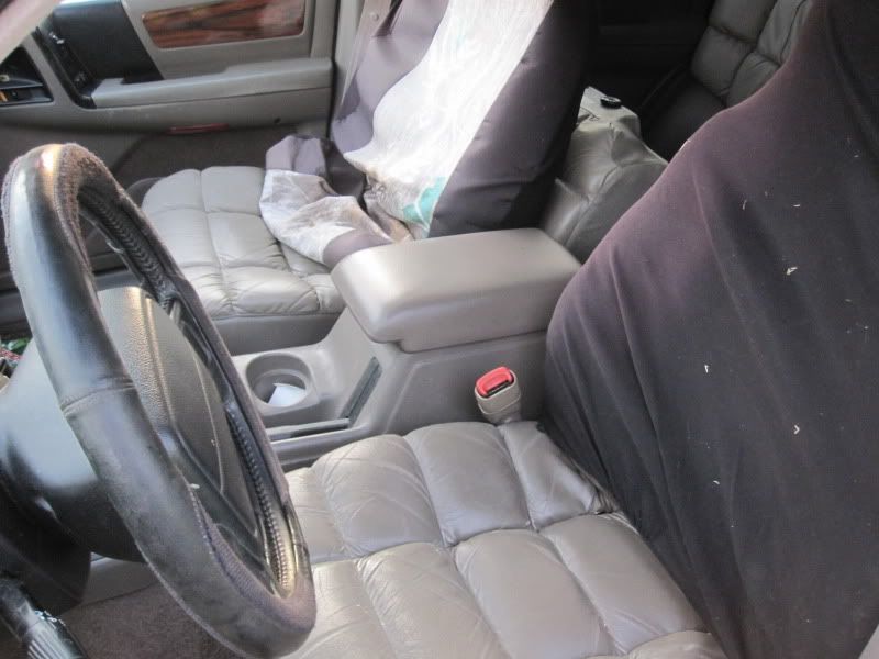

I think we are gonna keep the comfy leather seats for now. However, pm me what ya want for that cage

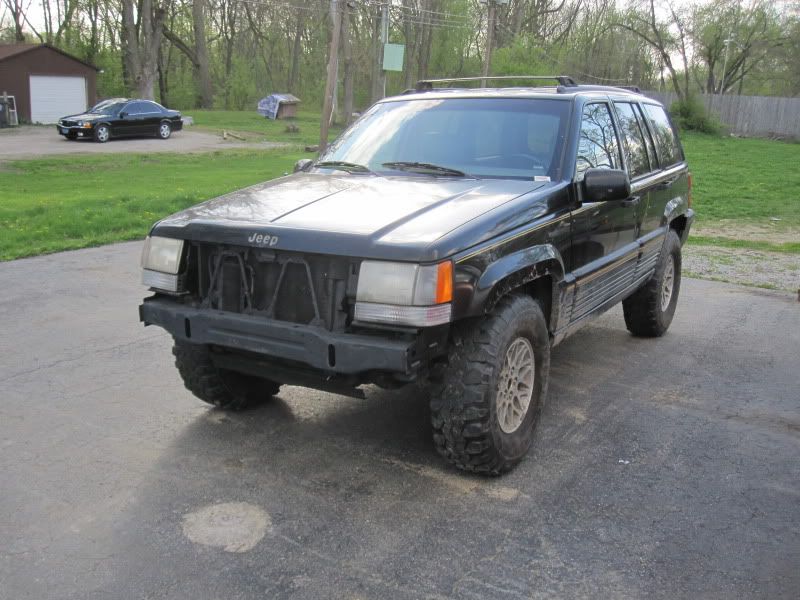

Got the fenders and bumper covers back on today. Also got the 32" Super Swampers mounted on the factory wheels just to see how it sits. Those wheels definitely wont do, which we knew. Gettin some better wheels from macgyver tomorrow most likely. May also be getting a b-pillar cage from him that was run in the ZJ he ran last season.

Well, they have lots of clearance issues with those wheels. Once we get them out farther, we can start doing some minor trimming to clear the tires. We should be around 2-3 inches lift when its all done.
Trying to stay in Class C as well

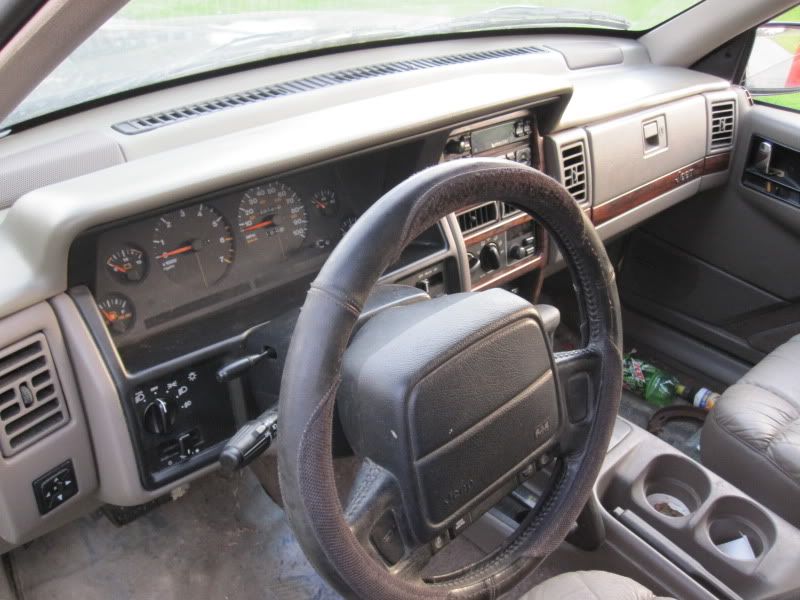

Anyway, today i got the dash put back together. Also got the drivers window fixed. It had come out of the regulator and fallen in the door. Got it glued back in place. This thing really isnt in that bad of shape. If it werent high miles and already destined to be a racer, id be tempted to sell my car and daily this thing.

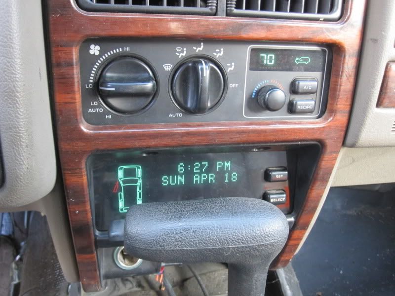

And got the hvac controls (with automatic temp control might i add) working, as well as the information center, cuz dammit i want to know what time it is, what day it is, when my next oil change is due, and what doors may be open while im racing!

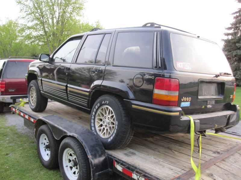

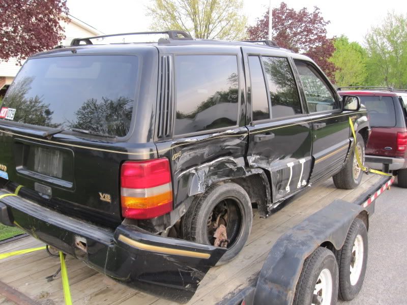

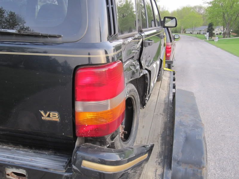

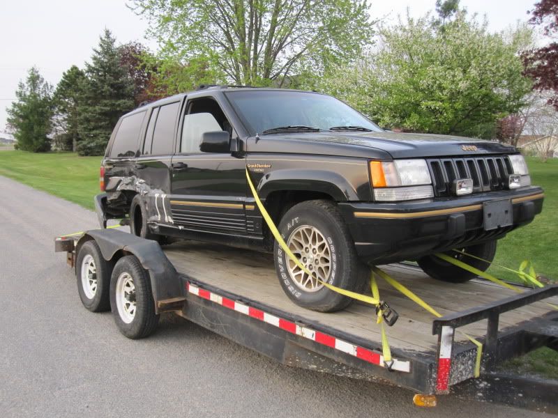

What have we become?! Went and looked at 2 more ZJs today......and bought one. Bryan, my coworker, bought it actually. Its a 95 Limited with a 5.2. Pretty much exactly like mine, only 2 years newer. Probably one of the cleanest ZJs ive ever seen. No damn rust anywhere. Interior is spotless. Under hood is clean, no real leaks. Same with underbody.
The bad.....she got smacked on the right rear pretty good. Tore the wheel and brake assembly, complete with caliper and bracket, clean off. Gonna need an axle to drive.
Right now he is in the decision process of try to fix it and race, or part it out. Told him ill go in half of the purchase price if he decides to part. Ill take what i need for mine, then we will split the rest of the profits from parting.
Its actually kind of a shame this happened to it. It really is a nice clean ZJ, hard to find. Funny thing is, they said he got hit by a Wrangler. Apparantly all it did was mess up the Wranglers headlight lol

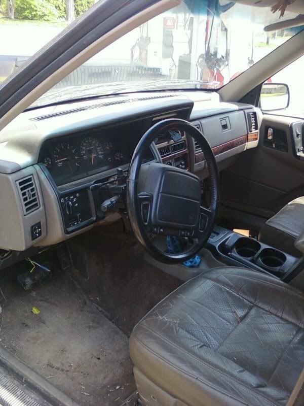

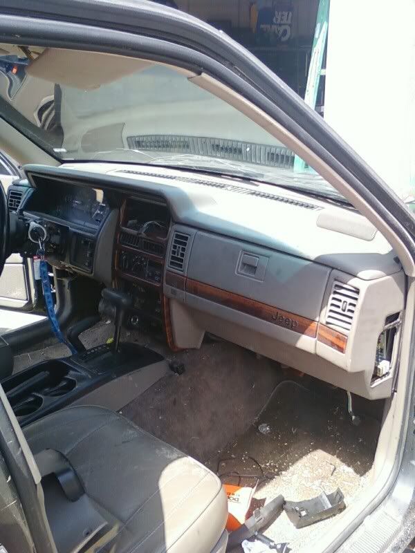

sorry, havent been taking many pictures lately. Been pulling late nights at the shop workin on the thing and never take a break for a pic. then by the time im done, i just want to get home to bed.
In the past few days ive been doing lots of welding. Cant really disclose what all ive been welding cuz i wanna keep some secrets to help with some advantage.
I did get 2 spots on the floor hillbilly patched. On the front seats, both rear, outer bolt locations on the floor had rusted through, barely anything holding them in. So i pounded out all the rust and welded in some patch panels. Then drilled new holes. I used a second small panel on the bottom that i just bolted in to "sandwich" the floor panel for a better hold. I didnt feel like grinding through all the anti-rust undercoating (that didnt work might i add) just to weld the panel in. This will do just fine.
Ripped the headliner out because i knew id be welding inside and it would just get burned anyway. Then i got the cage for it put in. Had to cut the rear bars off to fit it in, and then welded them back in place once the bar was set in its spot. Tomorrow im going to make some base plates to weld to the feet of the cage. They will in turn be bolted through the floor to another set of plates that will be welded to the frame via some tube.

Did a lot of work today. Went through and replace a lot of bolts, upgraded to grade 8 where there werent some. Need to replace the you.c.a. bolts all the way around, but couldnt find the right size.
Fixed a problem with the front lower shock mounts. Installed extended bump stops in the front. Need to make a bracket to shorten the up travel in the rear, so the bumpstops bottom out before the shocks. Got another set of lights on the roof. I didnt have near enough light at the last race, especially with my headlights out. Makin sure that dont happen again. Turns out it was just a fuse that took down the headlights which is what i figured it would be. Since the factory fuse panel cover doesnt have them labeled out, i took a sharpie and a diagram of all the fuses and wrote on the front of the cover what the necessities are. The rest are just spares as far as im concerned.
And i used my nice new $200 body saw to trim a good 1.5" from the front fenders/bumper, and about .5-1" from the rears. Couldnt go as much in the rear due to some panels comming together there. If theres one thing im seeing, its dont mess with the structural integrity of the popcan if ya want it to last at all.
What i hope to get done by next race: limit straps, HID, truss axles, lengthen rear track bar

She started a diet today. Getting gutted, all non essential interior and underhood components are getting pulled and tossed

have you roll caged it yet? is that allowed for your class?
 Post subject: Re: TREC racer
 Post Posted: Fri Jun 11, 2010 10:08 pm
is allowed, not required but highly recommended. I do have a cage in mine. Nothing fancy, just enough to hopefully keep the roof off my head if i roll

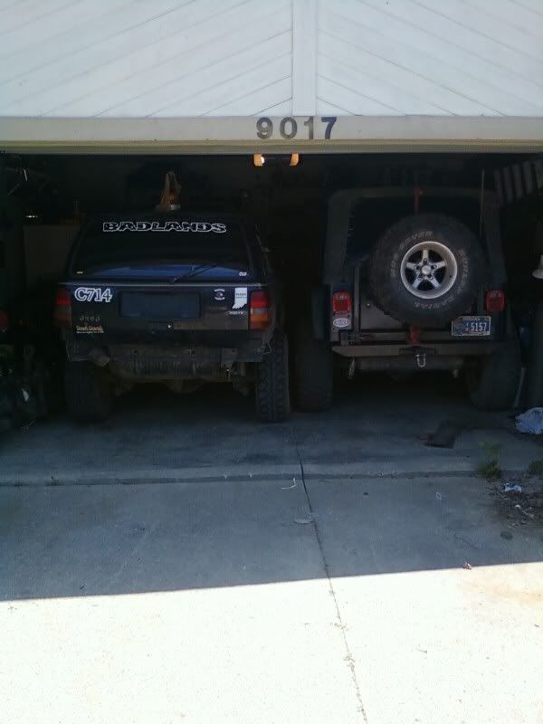

Well, recently i lost my job. Unfortunately, the shop i was at was also my storage facility for the racer, just didnt have enough room at home. So, when i lost the job, plan was to get the racer home, get the shocks off and put on the TJ since its shocks are completely blown out and damaged. Then pull of useable parts for the other racer of Bryans and scrap the rest. However, every time id go outside, id see the race sittin in the garage and it was a reminder of how much time ive put into the damn thing. So, i just simply couldnt bring myself to get rid of her just yet. So the work began and after a lot of cleaning the garage (not only do i need to fit 2 jeeps in it, i have to fit the tiny tool box i already had and the tool box of things ive acquired as a mechanic for six years), i got everything to fit.....very very tightly. Ill have to pull one of them out to do any work, or to even get to anything in the garage, but i am very proud that i made them both fit lol. Cant afford to get her race ready right now, but at least i can sit on it until i find a job. Already have a front axle, but need a rear axle to match the different ratio (dont really wanna spend money on setting up a diff)
First i drove them straight in, but i needed assistance making sure i wouldnt hit anything since i need them as far to the right as possible.
Then, after pulling them out to get some more stuff done, i decided to back them in. This way i can see everything and get them squeezed as far to the right of the garage as possible
Check out how bent that front axle is lol. Thats what jumping a ZJ over and over and over again will do to a non-trussed d30. But, if you look just to the side of the ZJ, theres another dana 30 waiting to go in
