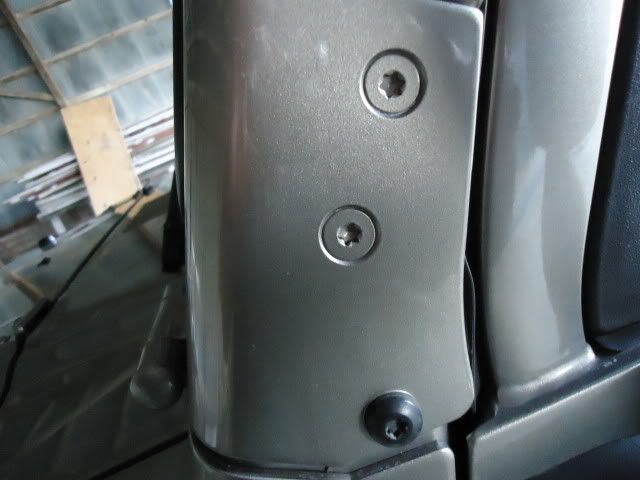

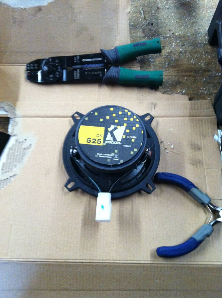

Welp tonight I worked and worked........and worked some more. I fixed my speakers. Turns out to be a bad wire so I didn't need new speaker, Ill either keep and install them later or might sale them. Well I was there I took the radio out........the guy that owned it before me was a flip-in moron. All the wires were tape together with BLUE MASKING TAPE!! I spent an hour or so soldering them together and covering them right. Oh anyone would like audio help or soldering, just ask. Its all I did in high school. So that was taken care of, I moved on. I did the head light.. 1000 times better! Oh my gosh these thing are awesome. Only took me 30ish minutes to do it. Then I was going to do windshield lights and mounts. Well I couldn't get the frigging bolts out of the hinges! I got the lower outside one off and the mount on but Id at least like one more bolt so there more stable. Anyone have any tricks for this or suggestion? Hopefully someone does. I could use the help. Might have to take it to a shop and see if they can do it. Well that's it for updates for now.
 Post subject: Re: Moosicon Build
 Post Posted: Wed Jan 04, 2012 7:56 am

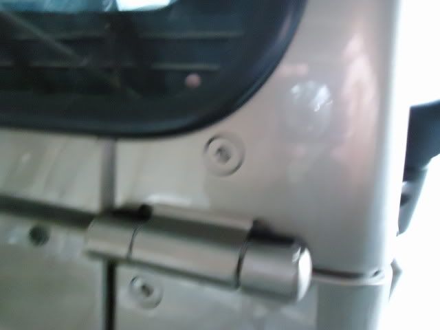

Snap a quick picture of the stubborn bolt & throw it up on here..
 Post Posted: Wed Jan 04, 2012 5:56 pm
As requested by Mr. Alpine
The body colored ones, on the top hinge. I can get the black one just not the others
 Post Posted: Wed Jan 04, 2012 6:27 pm
That's what I was afraid of. I hate flush torx bolts.
I would get yourself a Craftsman torx bit (or 3) for those particular ones. Those are the only ones that I am aware of that are precise enough to not round the holes out. I've heard of people welding nuts to the top of them to get them out (and then replacing them afterwards), but I have not had that kind of success doing that. :(
 Post Posted: Wed Jan 04, 2012 11:40 pm
I bought a set of craftsman torx bits tonight. Ill see if itll help in the morning coffee
 Post Posted: Thu Jan 05, 2012 11:45 am
put the torx bit on their, be sure it is the right size, even when you think you've got the right size, double check with the next one bigger.
Once you've got the proper size torx bit, place it in the bolt, then smack it with a deadblow hammer, try to loosen bolt, if no luck, try to slightly tighten it, then try loosening again. Be sure to keep a steady inward pressure on the head of your ratchet, to keep plenty of down pressure on the bolt as you back it out, to keep the bit from slipping inside of the bolt.
Part of the issue is that the size of the bolts is affected by the paint (they were installed factory prior to painting). That is why you should always check a size up, then hammer tap it in. Also, hammering the bit in will allow for some vibration or what not in the threads that should help free any oxidation that may have built up causing the bolt to stick.

 Post Posted: Thu Jan 05, 2012 2:29 pm
Well I tried it all. 2 of them are close to rounding but the splines are still there so Im going to take it to a shop down the road and see if they can get them
 Post Posted: Fri Jan 06, 2012 5:29 pm
One of these will change your life on torx.
http://www.harborfreight.com/media/catalog/product/cache/1/image/9df78eab33525d08d6e5fb8d27136e95/i/m/image_17210.jpg
Craftsman has nicer ones but the HF one works great.
Also IIRC the two front ones have nuts behind them inside.

I was going to say get an impact driver like that. I have one here at work and they work great on stuck screws and bolts like the ones on the windshield bracekts. I had to use it on mine when I put my lights up there.
 Post Posted: Sat Jan 07, 2012 12:18 pm
Hmm I might try that driver.
I have an impact but I was afraid that it would strip them.

I would not use a regular impact for the reason you stated. This is pretty direct even force with minimal turning action. They do work like a charm on certain things.
 Post Posted: Sat Jan 07, 2012 6:33 pm
 Post Posted: Sat Jan 07, 2012 10:36 pm
WOOOOOOOOOOOOOOOOOOOOOOOOOOOOOOOOOOOOOOOO :lol: My dad got a small 3/4 impact driver. It did the thing.....but I a socket shit :doh: So off to sears in the morning to replace it! Good thing I go craftsman

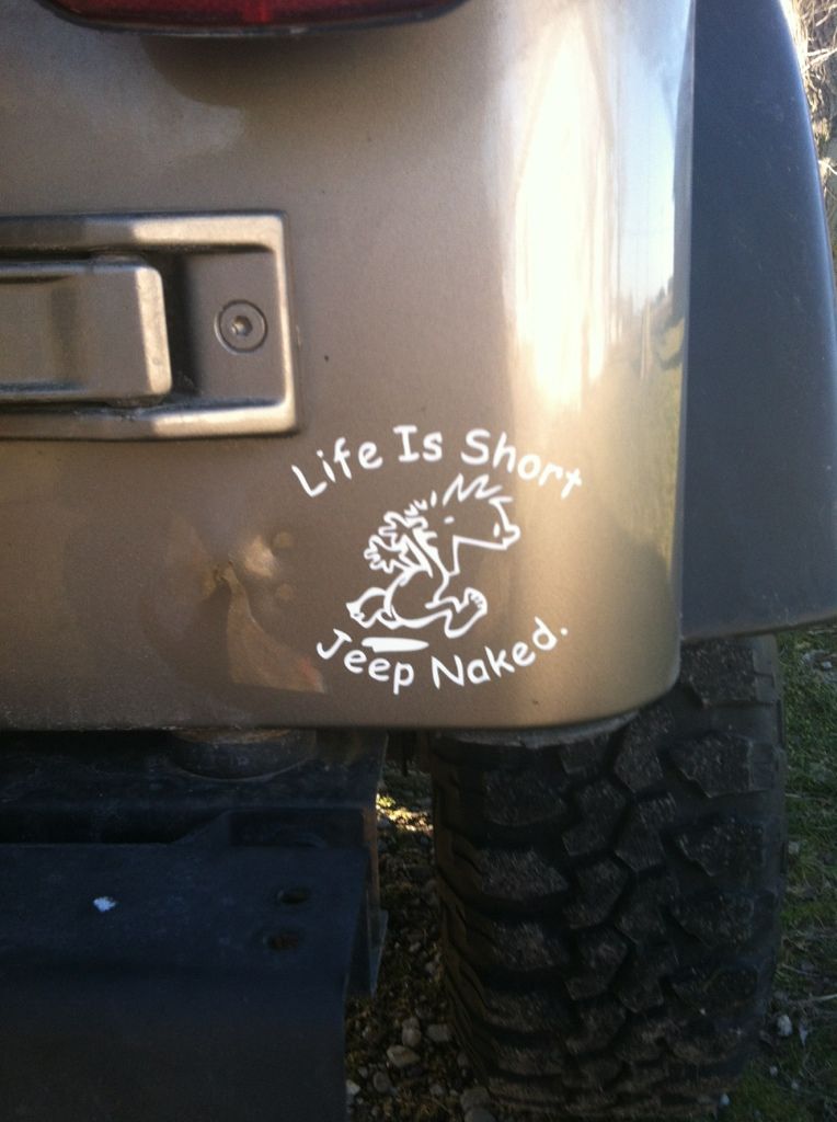

I took her out for a little ride today
Also bought more stickers

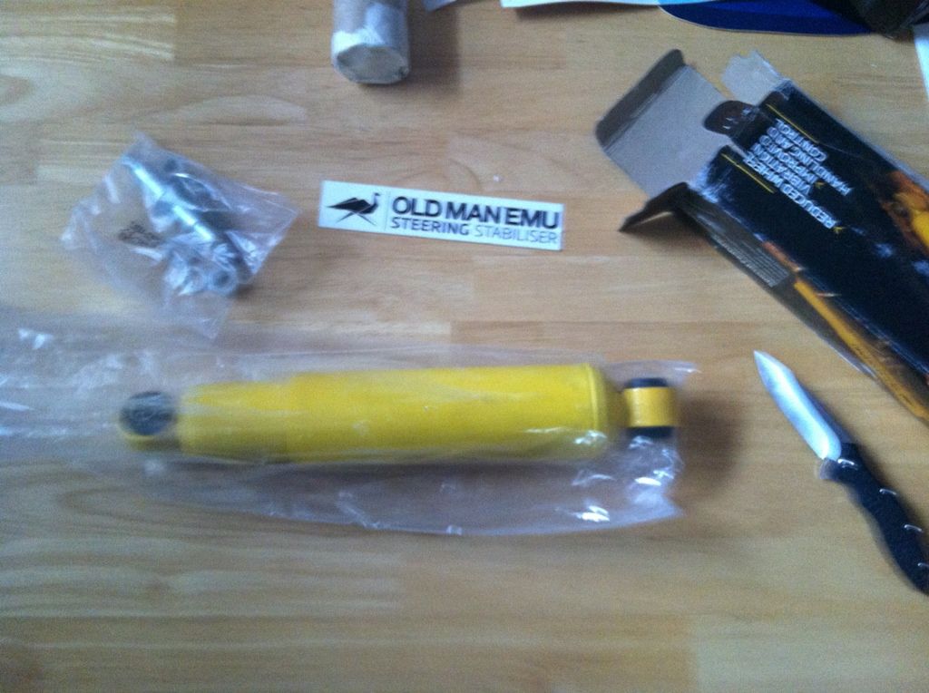

I order this
I went on a small wheeling trip with a couple a guys down and and we went a crossed a brush field and the other TJ got his radiator cracked by a small tree. The funny thing was I went over where he had just before him and mines fine. So I figure better safe then sorry.

I GOT MY MUTHER TRUCKIN DOORRS OFF!!!!!!!!!!!! BOO YAH!!!!!!!!!!!!!!!!!!!
On a side note I need new door bushings and one new bolt.........scratch the bolt need a new upper hinge :bs:
 Post Posted: Mon Apr 23, 2012 1:16 am
The bushings was ate through on both the bottom hinges, the passenger one was hard but we got it with a few love taps with the BFH. When we went to the driver side we couldn't get it with the hammer and pb blaster was helping but not much so we removed the hinge from the the completely. Took a board and the hammer put it on the hinge and hammered till it came off. Pulled to ate up bushing out and cleaned everything good. Wraped it with some white plumbers tape to help with the lack of bushing and put it back on. Once it was on, we were putting the nuts on and the little thread part of the pins snaped off the bottom pin. So I will be replacing that once schools done.

 Post Posted: Mon Apr 23, 2012 12:43 pm
you don't really needed the threaded part on the bottom on the hinge pin... just makes it take longer to remove the doors...

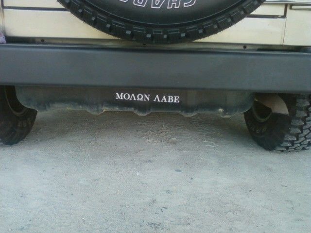

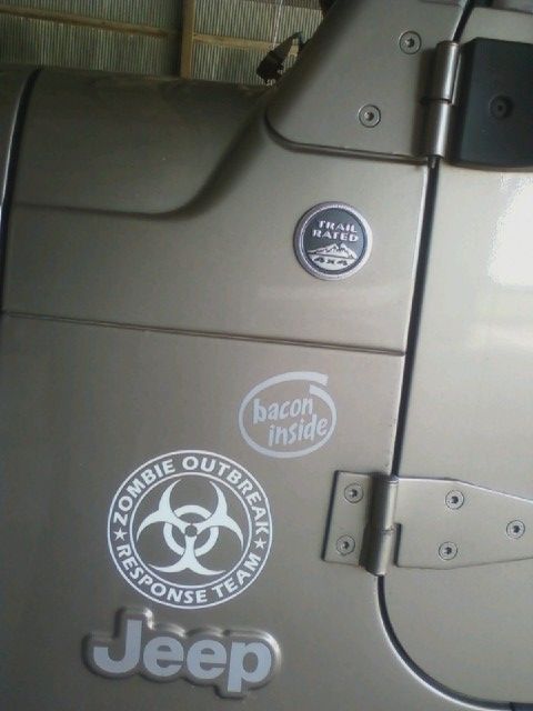

Stickers are on!
Windsheild
Side
Rear
Gas Tank
 Post Posted: Sat Jun 02, 2012 4:11 pm

 Post Posted: Fri Jun 29, 2012 1:37 pm
New speakers in my sound pods. Its a killer sound now!
Stupid cheap covers wont fit in the sound pods

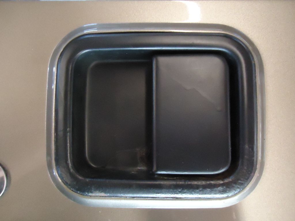

Got a picture with the doors off
And I also bedlined my outside door handles
Old
and
Now

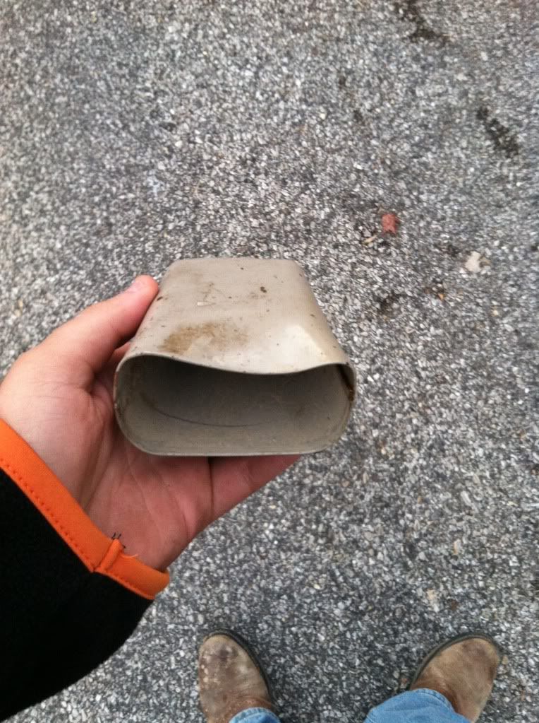

 Post Posted: Sun Oct 28, 2012 1:15 pm
Cowbellin!

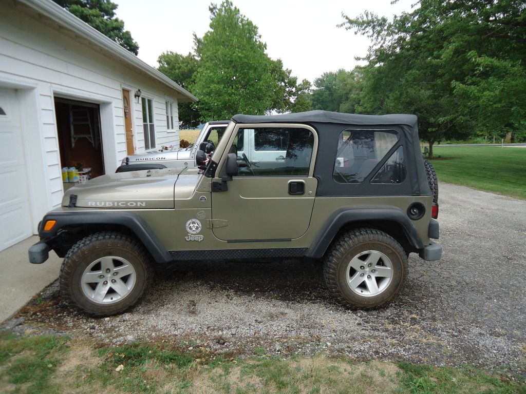

 Post Posted: Mon Dec 31, 2012 9:21 pm
Ready for lift and new bumper

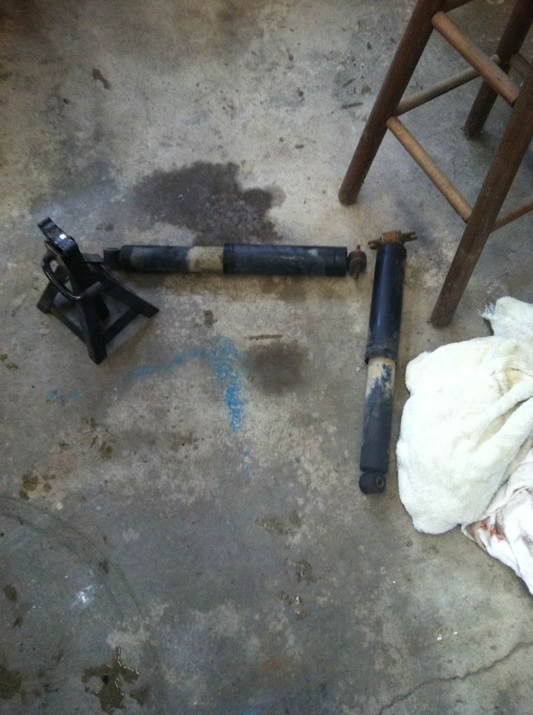

Update to, taking a break and got a late start. Rear shocks out and are waiting for springs. Oh broke one upper bolt per side.

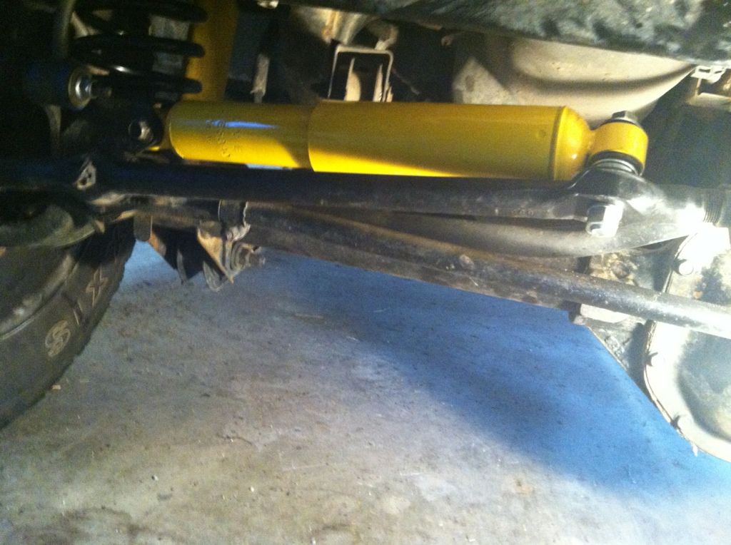

Pic update. Crappy cell phone
Spring in and trac bar thing
Rear all together
Height pictures
How the front sits
Parts pile

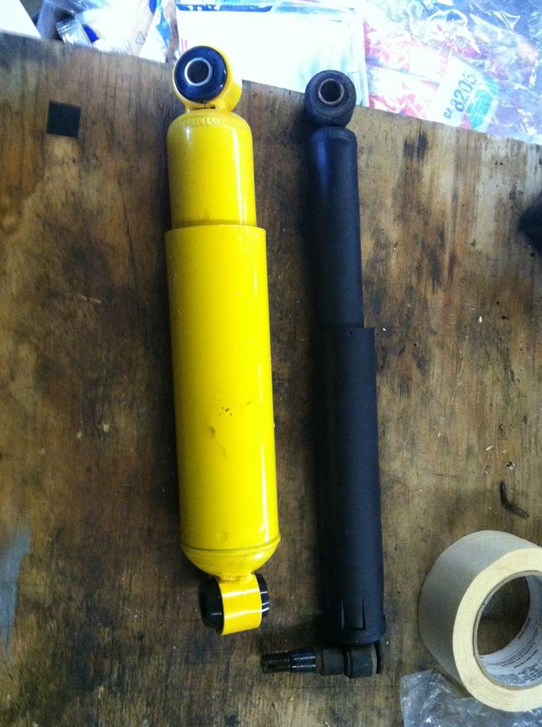

Yes sir, finished basically about a half hour ago. Waiting till morning to tighten everything and go for a test drive. So tired now
Pics
Springs and such
Shock and new sway bar link cause one of the old ones broke
Parts piles

Stickers are on
My KC's on the road
and me parking on whats left of the snow

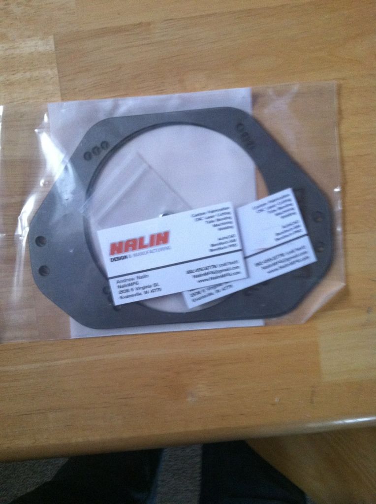

Speakers adapters

New Steering Stabilizer

test fit the adapters
Old vs New
Soldering job
Plug on new speaker
Speaker installed on adapter
Installed
and Repeat

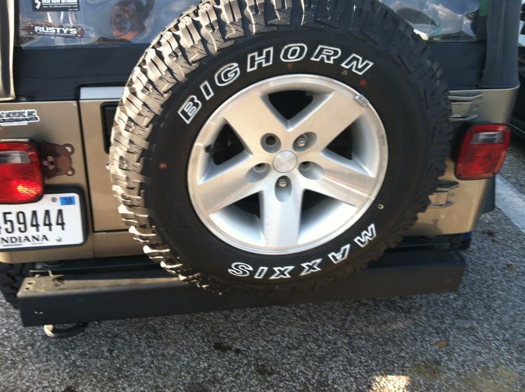

and just for kicks. Here is a comparison on the new spare and the th tires with 20k miles on them

Old vs New
And new is on

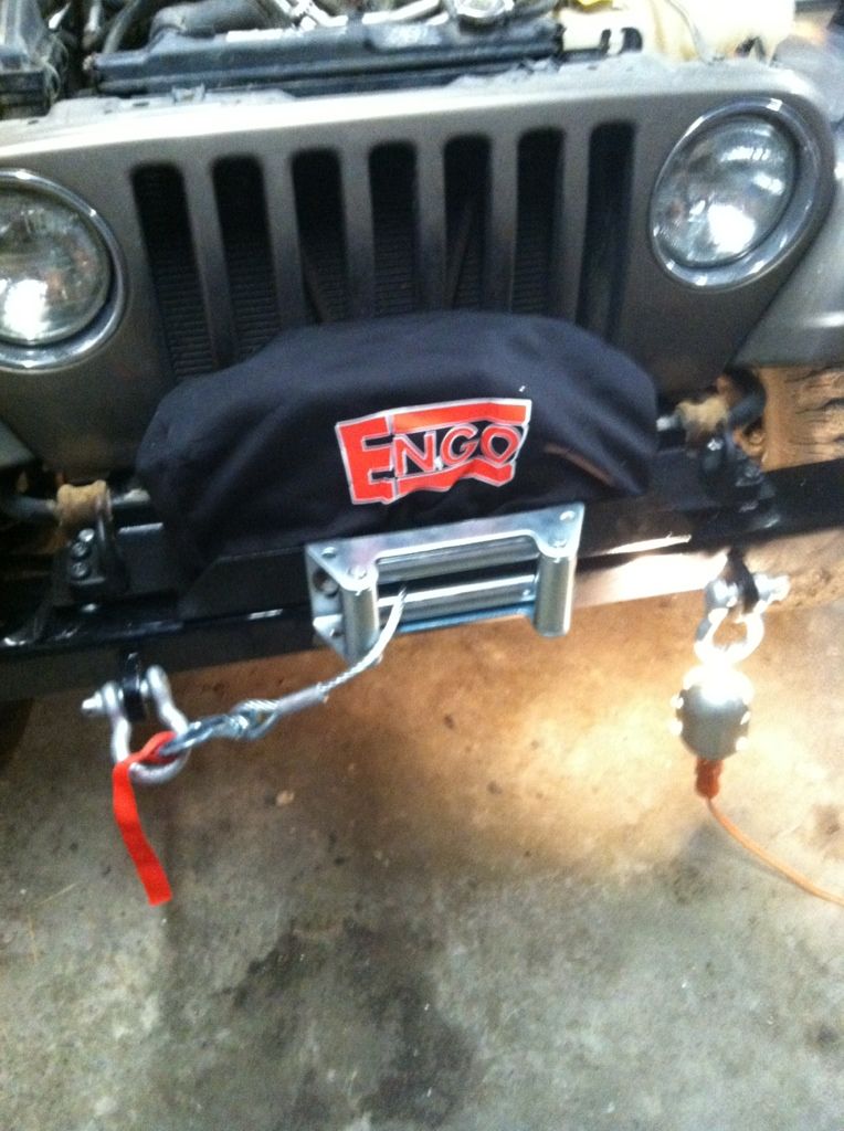

I just ordered a winch, plate, and cover. Stupid tax return.

I ordered the Engo E10000. Well I originally was getting the the 9,000 lb version but they upgraded me for free so I can't complain.
Here is a winch shoot out and they did just as well as the Warn.
http://www.fourwheeler.com/techarticles/129_1107_massive_multi_winch_shootout/
I spent less the $400 and got every shipped to me door. So not bad

Winch on!

 Post Posted: Wed Sep 04, 2013 3:31 pm
So I haven't posted in awhile.....SO HERE GOES!
Replaced the crappy looming on my windshield lights
Did some snow wheeling
Beer can tower
Bought an old dart to fix up
Night wheeling
Pretty shots
More pretty
And why not

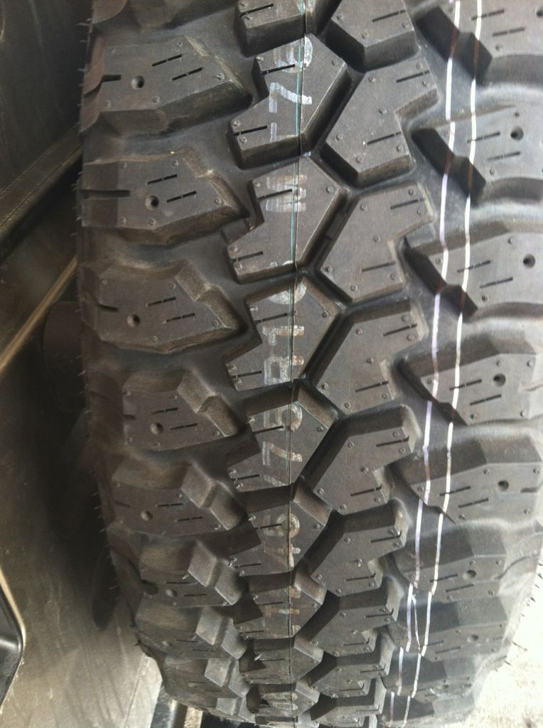

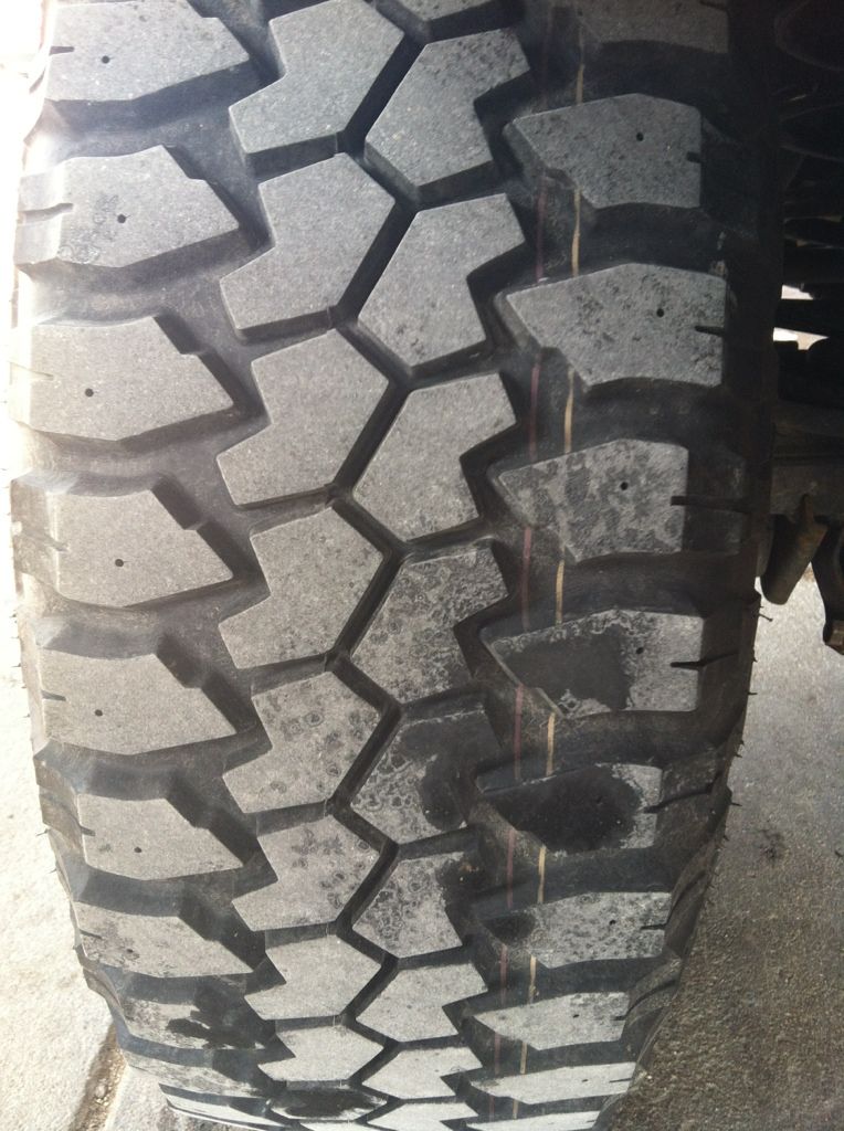

New tires, 285/75R16. 33X11.5 Fierce Attitude

More STICKERS!
Comparison of lights
None
Headlight
Brights
All
