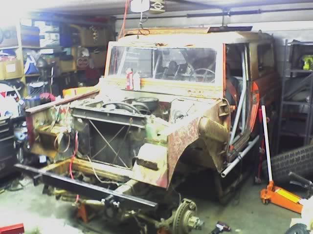

Day two.
I pulled the front driveshaft, doors, and front tires. I disconnected a bunch of stuff under the hood and thought about shit, then decided I would have to pull the grille to get the motor out. Fenders ended up coming off as well.

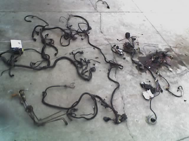

Day 3.5. (sunday)
Towed the Scout to the carwash and hosed it down. I figured it would be more pleasant to work on if it was clean. Cleaned Saturday's mess while I could, rearranged a few things as well. Now I have more room and some empty shelves too.
Paid Chris for the motor and t-case, went to Topper's for the wiring harness. Holy crap there is a lot of wiring! TBI is a lot simpler, but just how cool will the TPI look under the hood? :tu2: I'll probably use about half of the wiring. I really wish I had the motor here so I could plug everything in and label it.

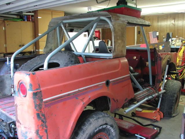

 Post Posted: Mon May 14, 2007 8:13 pm

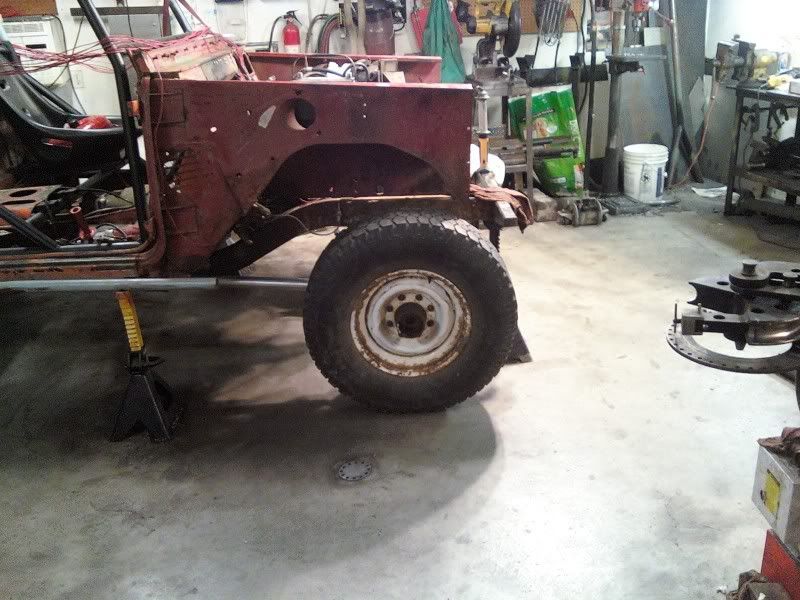

Well, after moping around over not having parts, I decided to work on something. that something happened to be the in-tank pump. I have read of people using the e2000 pump from a 88 Ford truck, but it is a more expensive pump than the stock one. So, I thought I'd look into doing an in-tank pump. I didn't see much on Pirate, so I am pretty much on my own.
What I did...
I went to Barto's. It's a circle track shop on Creighton, about two blocks west of cop central. I picked up two -6 AN bulkheads, nuts and nylon washers for about $22. After riding about 30 miles back and forth between Barto's and Napa trying to find the right fittings, I decided to go to the hydraulic shop on west main. I forget the name of the joint but it is about a block or two west of O'Sullivan's. They set me up with some seamless tube and the right fittings to put a hard line to the AN bulkhead. That was around $5, but I later went back to have something flared because my flare tool wouldn't work on the harder seamless.
The pump and tubing assembled.
I talked to Topper and Macgyvr about spare tires. I was wanting to set up the Scout to carry one, but they sorta convinced me it's not needed for wheeling the local spots. So, instead of turning the tank sideways and standing the tire up next to it, I sunk the fuel cell through the floor. I wanted to do that anyway, but turning the cell sideways wouldn't have let me. Anyway, out came the sawzall for the sheet metal, and the welder for the cross member. Afterward, I ended up taking all the floor out up to the bulkhead. It was rusted through and ready to fall off anyway.
The square thing at the bottom of the pic is a frame I built to hold the fuel cell, there will be some supports and some "floor" to it later.
Here is the cell sunk down to the bottom of the frame, about 5 inches. I'm not going to make it permanent until I get the rear axle in and can see how much clearance I have.
And again with the "spare" in. It will probably take two people to wrestle it out should I need it. It shouldn't move where it is, but a ratchet strap over it wouldn't be hard at all.
Another view.
It's a halftop!

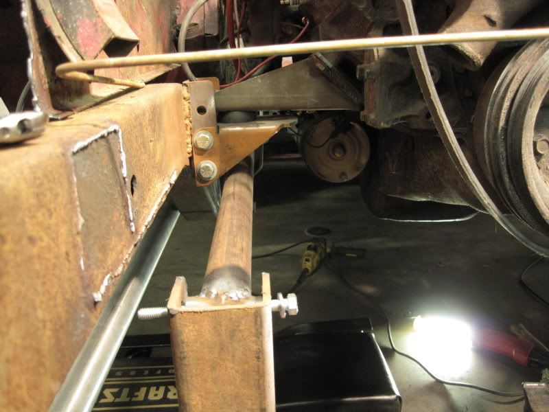

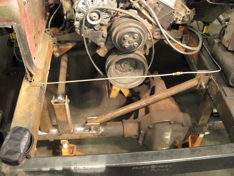

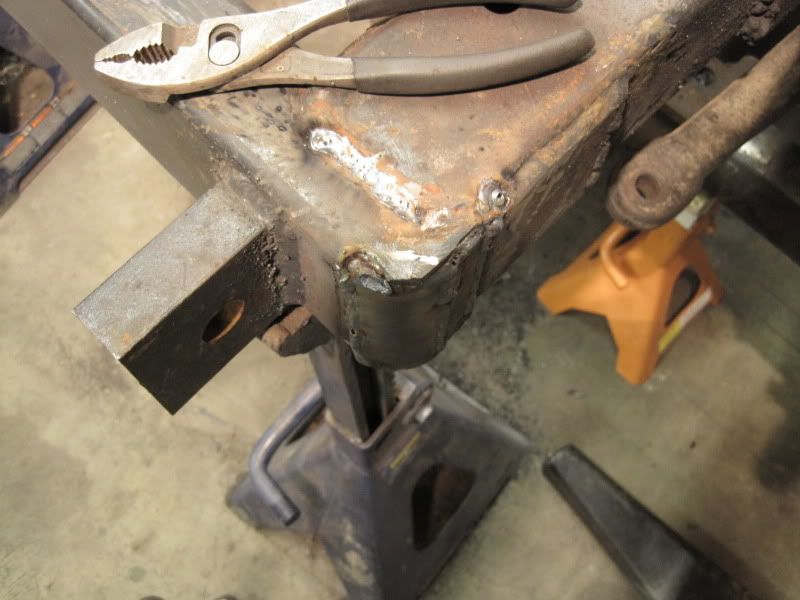

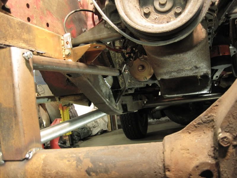

 Post Posted: Fri Jun 01, 2007 6:55 pm
It's been almost two months since I had the motor in the engine bay. I sat and designed a trans crossmember, then it took it to a local shop to get the parts cut. It took two weeks to get ahold of the guy, a week to get an estimate, and 4 weeks to get the parts, and they weren't quite done yet. They were cut out, just not formed. (bent) I got one extra on all the parts.
There's one of each. I used a sharpie to mark where they were going to be bent and used an angle grinder with a cutting blade to cut 2/3rds to 3/4 through. That makes it easy to bend. Just be sure you cut straight or your bends will be wrong.
Bend away from the cut and weld in the cut.
Here it is, on the left is how the parts go together, one piece welds on the frame, one piece welds on the end of the tube so you can bolt it down and the last piece welds in the middle for the trans mount to bolt to.
Now that I have parts I can get the motor in and start wiring and fuel.

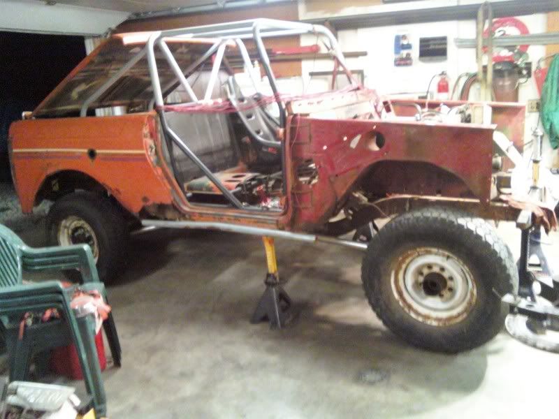

 Post Posted: Sun Jun 03, 2007 1:30 am
Early morning report, 1:20 AM and the motor is in. I am pretty sure my welding will hold, but I am not sure the front output will clear the new crossmember. Will get the tcase in and some pics up tomorrow.

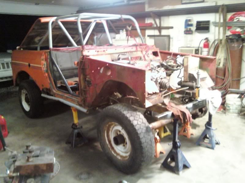

 Post Posted: Sun Jun 03, 2007 10:28 am
Two hot dog fridays and no Tuff guy? People were wondering.
I said I would post some more pics, and here we go.
The crossmember turned out fine, but next time I will have it all bolted together so I know exactly where the mounts will end up. Without the mount it looked like there would be lots of room for it, but it turned out to not be the case. The frame brackets ended up being above the tube instead of below like I wanted, but what else could I do? After it was in I realized that I probably won't have room for the front d-shaft.:doh: I'm going to stab the case in today and see.
I started with this?
Image :doh:

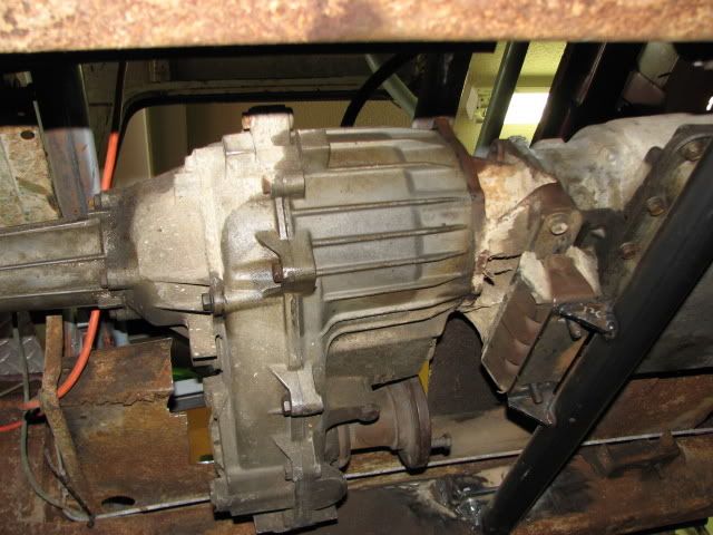

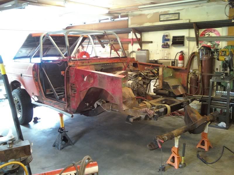

 Post subject:
 Post Posted: Sun Jun 03, 2007 6:32 pm
I killed a sawsall doing this... it was a slow painful death with sparks and crap shooting out of the side. :acclaim:
First I took out the seat and cut out the storage box that was under it. It was useless since there was no way to get anything in or out of it. Then I used my hoist to lift up the tcase so I could see how much I needed to cut. Turns out I had to cut a lot more than I thought.
From the other side, you can see how much I cut out better.
Turns out the crossmember won't be in the way after all, but I am not done cutting the body for the front driveshaft. the rear shaft is going to be short.

A month and a half has gone by...
Most of it has been spent screwing off, going back and forth between deciding on the 7165 ecm (MAF) and the 7747 ecm (TBI, SD) and going through the wiring I have. Finally I decided on the 7747, partly because I can do EBL in the future, and partly because I didn't get the ($200) MAF sensor with the motor. I went pin by pin and removed the unused wires and moved some others. When I thought I was done I plugged everything in and started on the truck wiring. Going on advice from others wired through relays and run the grounds through switches. If a wire shorts going through the firewall whatever it is controlling will just turn on rather than start a fire. Another thing I did was run the distributor power through the oil pressure switch (comes on at 5 psi) Should I lose oil pressure it'll kill the motor before I run it dry.
I did have to take the conduit off a couple more times to chase wires, pull unneeded stuff and add a few. Not quite done yet, going to chase the torque converter lockup wire and maybe put it on manual control.
About 1 am, with no MAP sensor, open exhaust manifolds, the TPS wired backwards (TPI and TBI are backwards from each other) and some 12 ga wire in place of the #2 plug wire (WTF happened to that wire???) I had ignition. It took a visit from the ether bunny, but it went.
Before I run it again I need to hook up the alternator so I don't kill the battery again. I do need to time it, it was hard to start and hard to rev. Had flames from the exhaust. Checked timing and it was retarded so I advanced it a tooth, but the battery was too low to start it again.
That's it for this update.

 Post Posted: Sat May 03, 2008 10:06 pm
Progress is slooowww but there is some.
My one ton axle is an Eaton. It looks like a 9" on steroids, but has a removable rear cover. It's the same as Macgyvr's rear axle. Supposedly just as strong as a 14b but lighter. Only thing is the one I bought has 4.10s and I want better. Next step is 5.13. :tu2: I had the third sitting on the floor of the storage locker for awhile, uncovered, so there is some dirt in it. Parts for these are hard to find an expensive when you do, so it is worth my time to tear it down and give it a proper cleaning. I posted this in another thread, but here it is again. I should take another picture with a pop can in it for reference, the thing is beefy.
I don't know how much weight I lost with the drums and backing plates, but it was probably 20 or 30 pounds. I couldn't get the adjusters to back off, so I pounded on the drum from the back until I could get a couple prybars in there and wedge it off. Then there was a dust shield that came off with a few hammer taps and 4 bolts holding the backing plates on. Knock the studs out of the hubs and the drums come off.
When I slid it back in the garage I put it behind the Scout and noticed how wide it is. This pic makes it lookl wider than it is because it wasn't right up against the Scout.
Here's a couple shts from right behind the wheels. Not quite centered, but you get the idea.
If I can get the 3rd cleaned, reassembled, and installed I'll start on the housing, cutting off the one link brackets and track bar mount. If not I'll be measuring for new leaf springs.

 Post Posted: Mon May 26, 2008 11:01 pm
Okaaayyyy...
I'll have pics up soon but this past week I have cut the mounts off the axle, pulled the d44 and springs, cut off the spring mounts from the frame, and moved the ecm once I realized that I had it right where I needed to run some tube. I also picked up a new 241 with the SYE and stabbed that in place. The only thing is that after I did I realized that the input was too big, so I had to yank it and pull it and the old one apart and swap inputs. :doh: I don't know how much those fuckers weigh but it was too much for one person to push it up there and get the bolts in, so I had to get creative with the ratchet straps.
Now I need springs and bushings so I can make mounts and get that axle hung.

 Post Posted: Fri Jun 06, 2008 2:39 pm
I was thinking about replacing the front springs and hangars for the new axle, but then thought I might just use what's already there. But, the d60 spring pad width is a half inch wider than the 44 that's in there now. I probably could have made it work, but I didn't want to bind the springs. So, goodbye d44!
I considered my options on cutting off the spring mounts, and the best thing seemed to be taking the bumper off. This let me get the grinder in there and also let me mount the bumper better.
If you look carefully you'll see that the end of the frame isn't square and has bolt holes in it. I couldn't weld it very well the first time, so I had an opportunity to fix it. The solution was to plate the sides of the frame so I could have a solid smooth edge to weld.
The back of the bumper was smoothed out, rust ground off the end of the frame, and everything was clamped and centered in place.
My welding on the top is very nice, but vertical and overhead need practice. When it's rolling I'll take it to a friend's and reweld it with a mig.
Lastly, since I have no money and nothing else to do under the Scout, I lowered it. Mostly I wanted the jackstands in a better place than under the seats.
At least this way when I get back to the dash and wiring it'll be easier to get in and out.

Changed my under dash wiring again once I realized that my ecm was in the way of future tube, also found some nice fuse blocks rather than the modified ZJ underhood box. Bought some autometer gages to fill the holes, and tested the dash with a battery. Just about done.
I had built the crossmember for the lower links and made tabs for the rear axle, but got stuck on the uppers and everything in the front. Soooo, I made a deal with a friend and that deal was that I would do the wiring on his CJ and he would do (or help) with the suspension on mine. We got his engine wiring done 2 weeks ago, so my rig went to his house. We decided on a 3 link with the 3rd link outside the frame on the passenger side. After the brackets were made and tacked in, we came the conclusion that if we push the front axle out 6 inches it would make it easier to put in a track bar. *sigh* Doing that means cutting new holes in the frame, cutting out the front crossmember, blah blah.
I have a list of crap to take over with me, including a camera. Here's a couple pics of where I am right now.
 Post subject: Re: Project Tetanus Shot
 Post Posted: Mon Aug 10, 2009 5:24 pm
I don't know if I mentioned it already, but it was realized that a double triangulated front would be not so easy to do while keeping the rig low. As a result, we went with a 3 link, and after more discussion, we extended the front axle out 6 inches. This gets us more room for the panhard and keeps the 3rd link out of the passenger side footwell. I am going to have to modify the motor mount on that side. Packaging will be tight between the motor mount, exhaust, starter, and link. While not nearly done it is at least rolling.
I had to cut my bumper down, so I used some tube to make a nice rounded corner. Needs finished, but you get the idea.
Crap engineering at it's finest. Actually some quick and dirty links to be able to roll it in and out of the shop.
Been thinking I should gusset the tabs on the frame end. What do you think?

Wheels and tires...
Got my front axle knocked out, 5.13 gears with a detroit. I still have a list of shit to do.
Front hoop
Mount radiator,fan
t-case shifter
trans shifter/tv cable/cooler lines
a little bit of wiring, mostly lights
hydro assist/steering column
torque converter
re-work motor mounts
trans cooling lines
driveshafts
interior sheet metal
finish front and rear suspension
upper links
mount struts
brake lines
relocate fuel cell, maybe build a custom one
tire carrier (winch powered? these wheels are heavy)
tube work
